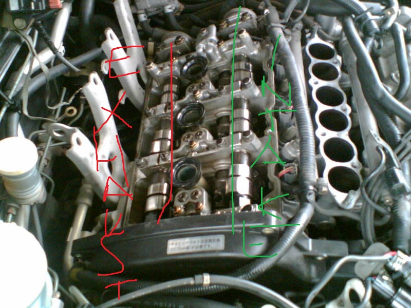

Was wondering if possible if someone can edit the following photo's in a program such as paint, with red arrows showing the whereabouts of intake and blue for exhaust? If it's even possible to do so in these pics? :s

mosti wrote:Was wondering if possible if someone can edit the following photo's in a program such as paint, with red arrows showing the whereabouts of intake and blue for exhaust? If it's even possible to do so in these pics? :s
Look at the picture you just posted...

Re: Intake and exhaust tappets?
I have no idea what your talking about but thought id throw up what I think your talking about and what I think is right.
Just thought id throw my guess in since we have been playing all these guessing games lately :lol:
EDIT: Waits to see what ben says :lol: :lol: :lol: :lol: :lol: :lol:

i love your paint writing skills :P
me 2

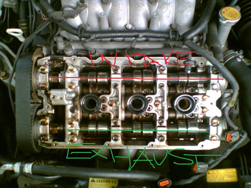

Sides as in top most bank and bottom most? (sides extractors are on).
So how many tappets are being adjusted at 0.10mm and how many for 0.13mm?
Is it 12 at 0.10mm and 12 at 0.13mm?
In the DIY it says the intake is 0.10mm and the exhaust 0.13mm.......
So the 0.13mm's would be all the tappets on the two outer camshafts (top most and bottom most). The 0.10mm tappets would be all the tappets located on the two inner camshafts.
So would the following be correct?
That look right? :scratch:
I'm a complete noob as you guys can tell. I'm trying to learn though so that's a positive haha. :thumright:
Correct.
