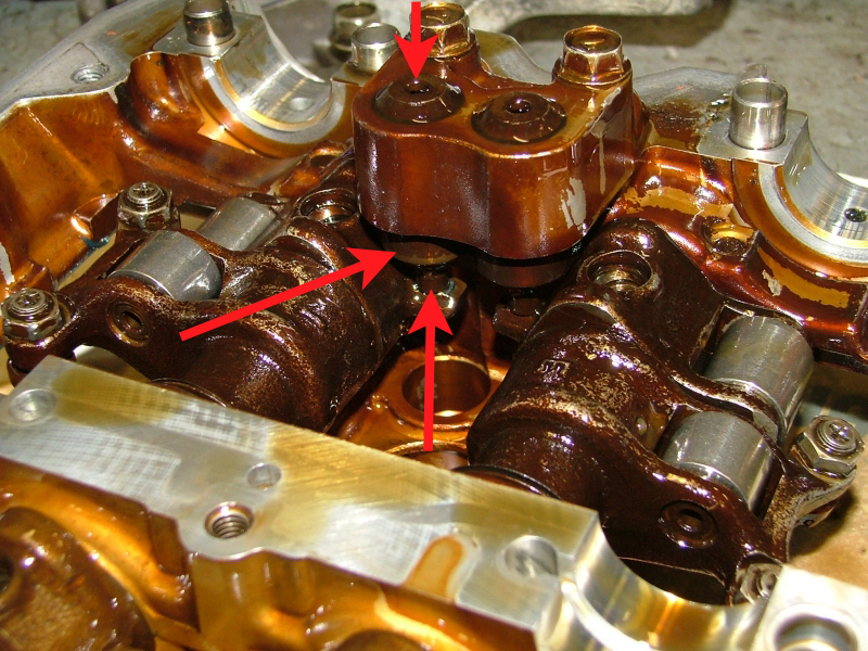

Ok guys I now pulled this engine apart the other day and this was the problem
1: there was a 40 mm grommet stuck in the middle front cylinder intake chamber where it meets to the head
2: well I'll just show a pic lol is crazy
All this happened in the front middle cylinder omg what a joke hahahahaha

Now that will do it
Did you not take the engine to a mechanic for diagnosis?
It would have been misfiring worse than when you leave an injector disconnected
Didn't the mechanic do a blow-by test with compressed air to each spark plug hole, as you would have heard the air escaping through the broken valve.

All it had done was a compression test and all were sweet but that one which had 0 compression was dads thought something like this but yeah everything happens for a reason lol couldnt believe the rubber grommet though lol

Yes you do a compression test first, but he had that done, and knew he had a loss of compression.
When I had a burnt/cracked valve in my old Fairlane V8, the mech used compressed air through the spark plug hole and we could hear the air escaping out through the exhaust.
At TAFE I learnt that you can do a blow-by test to determine the reason for no compression. You put an air blow gun into the spark plug hole with a cork to seal. You can hear the compressed air leaking through the exhaust or intake. You can also add a threaded fitting and gauge to the test and watch the comressed air pressure drop over time.
It allows you to determine if you have unseated/broken valves or broken/warn piston/rings/bore.

By eleminating the valves. So how do you know if if the compression loss is through the bores and pistons or valves with a compression test? The test is only a tool to help you determine what could be wrong. It would have worked here and it worked with my Fairlane.payaya wrote: So how do you know if if the compression loss is through the bores and pistons with your air test?
In ZFL45H1's case, if you ran this test it would have told you which cylinder was failing + you would have heard the air escaping through the valve, problem determined (as long as you had the cylinder on TDCC).
So you would have known what you were going to find before stripping the engine down.
Try it payaya, try it with a good engine, on intake stroke and on exhaust stroke and on TDCC.
