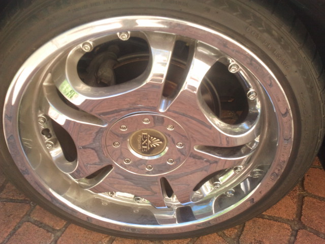

Yeah I think I am wrong about the 22 Inch part lol, they are not truck wheels.
- 2012-01-02 08.57.26.jpg (95.93 KiB) Viewed 282 times
Re: Help Please(About Tyres)
I think your best bet would be to sell those massive heavy chrome dishplates to some lebs on Boost Cruising & go grab yourself a set of 17" Buddy Clubs or something
- Posts: 33
- Joined: Tue Jul 05, 2011 12:49 am
Yeah I agree. They are just making my car look to leb, which is really really depressing. Also the fact that they are rubbing against the guards doesn't really help much to me liking them.

If they are the right wheel and tyre combination, then the overall diameter of the wheels and tyres should be the same as any other FTO. If this is the case, then you have simply lowered your car too much.
If someone has put on bigger wheels and tyres, then yes, returning them to the standard size will probably resolve your issue. Measure the wheels, and provide the stats on the tyre, and we can work out if it is larger than it should be.

I have decided that I will get 17 inch wheels, oh and the numbers on my tyres are 225/40 Zr 18 92w Xl. So my next question is where is the best place to get cost effective place to get tyres ib sydney
