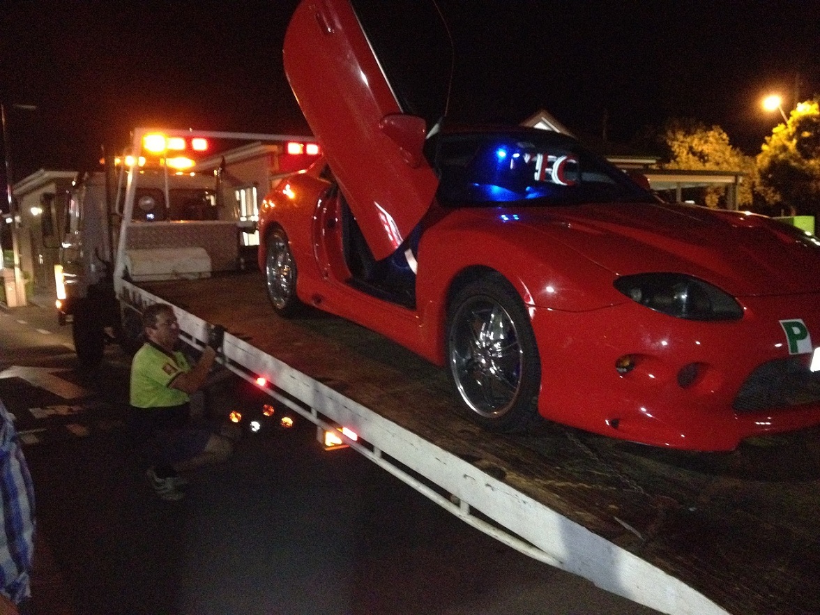

Sucks about the car :(
Although it does look cool on the truck with the doors like that :p

Re: Car stalled got towed back to base.
Well look at it this way there is one good thing thtat has come out of this, you got a good pic of your car and it is red too not pink :twisted: .
By looking at the pics it looks like your wheels are the source of the problem.

aza013 wrote:Well look at it this way there is one good thing thtat has come out of this, you got a good pic of your car and it is red too not pink :twisted: .
hahahaha jerk :p

Kustom wrote:By looking at the pics it looks like your wheels are the source of the problem.
i LOLed :lol:
