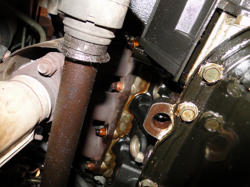

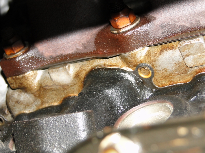

Rob Furniss wrote:$80 is pretty good, didn't realise they would be that cheap so yeah why wait.
When you get it all sorted I would look into fitting a transmission cooler.
How much is it leaking, is it enough to leave marks on your drive or just a bit on the casing?
looks pretty serious leak..
any comment..?easy to fix..?

- Posts: 1394
- Location: Perth
Re: 94 gpx need gearbox change.? and engine oil leaking som
Hope your gearbox is ok now.
Not sure about your engine oil leak, I have a leak in a similar place but I haven't determined where it's coming from yet - i'm hoping it's from the crank shaft seal and just spraying around that area as I need to do the cambelt anyway.
Try cleaning it off/degreasing it and check again in a day or two to see if it's definately from the head gasket or is just getting sprayed on there somehow.
Is it just from the corner and then stops by the time it gets to the middle of the block? If so it could be from the camshaft seal round the corner if you know what I mean but i'm no expert, just my thoughts.
Or is it from the sump and spraying up somehow?

- bryiano
- Posts: 21
- Joined: Fri Feb 03, 2012 8:37 pm
the N still come out after i change the gear box oil and i rekcon thats not because the heat. because the N start flashing in two minute after i start the car last nite..but will get a Input shaft speed sensor to have a try..
the engine oil can leak in one trip..not need days..
i wipe a little bit last nite and take the pic this morning after 30 minute run....look like the oil from the bolt..
..will check again..

- payaya
- Posts: 3670
The leak is coming from your rocker cover gasket or your plug seals leaking causing oil to go past your plugs.

- payaya
- Posts: 3670
Rob Furniss wrote:Hope your gearbox is ok now.
Rocker or plug seals. Bet your plugs are drenched in oil.
- Posts: 1394
- Location: Perth
I will be taking the plenum off soon so will check the plugs then, rocker seals are ok.
I'm reckoning camshaft seal but hard to know without taking covers off, guess I should get on with it and sort the problem out.
