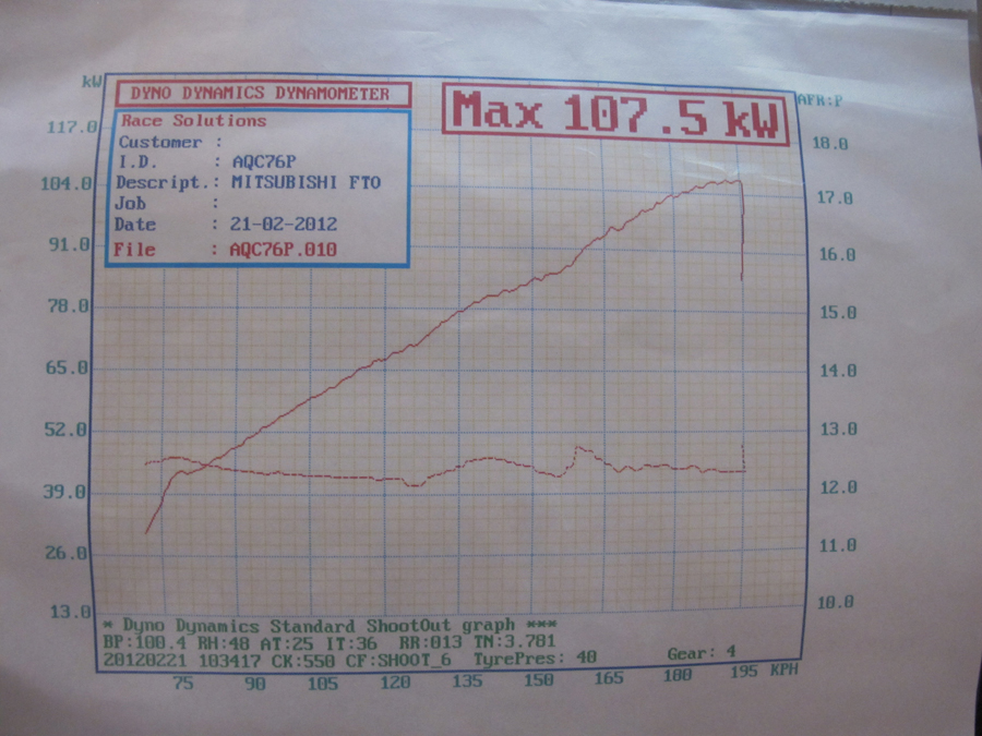

So I had went for a dyno run again at the same place to see if the manual conversion had increase the kw. the first run was a poor 86 kw atw. after manual conversion 107.5kw :)
now i am hoping to get more power(i'll be happy with 150kw range), can anyone comment on the curve and will Haltech interceptor do much? the tuner said the curve is ok and piggyback wont do much.

Either whack a set of extractors on, or at least bin the factory Y pipe under the motor where the factory headers joins. Its restrictive.

150kw? Good luck with that from a 6a12 na

Forget the haltech interceptor. Dont work very well with factory management system.
If you really want a piggy back I would resort to a EMS stinger, but for the price I would really rather go for a standalone computer (plug and play) and have control of fueling and ignition maps and not worry about the limitation of the factory computer.
150kw can be obtained NA in saying that you must have deep pockets. You will need to increase comp and get right cam profile to suit, work on sh*tty quench area of 6a12 (for that matter most mitsu engines), light weight rods (alum) and all other parts that will compliment the set up like custom headers and exhaust.
