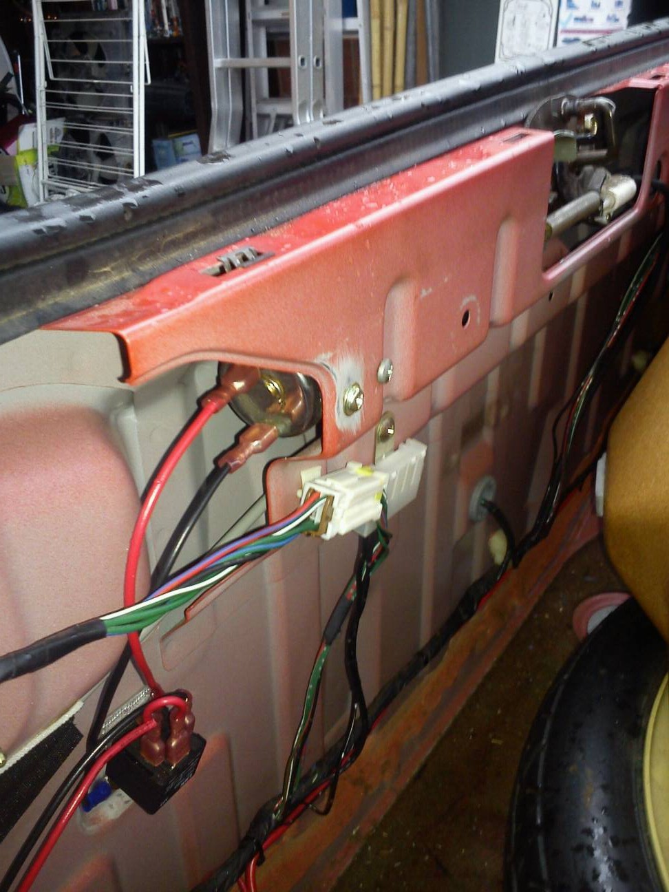

So last night Braydon (technikhaus) and I tried to install the boot release button I have been planning. We managed to get the wiring in and the actuator hooked up, but were still having one problem.
Because the button is on the outside of the vehicle, any old bugger could come up and open my boot (which usually carries thousands of dollars of equipment) and take all I own.... Yeah Nah!

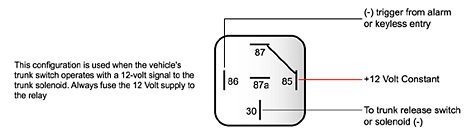

I would have thought it was default function of the alarm? If you have a boot pop button on the remote, then it would be. Otherwise, as Astron said, hook up the led & program it.
Then all you need do is run that trigger line from the alarm to a relay, and depending on what type of trigger (its usually a neg trigger) then wire as follows.

This is the button we have installed.
We also have no idea where to wire the LED into
