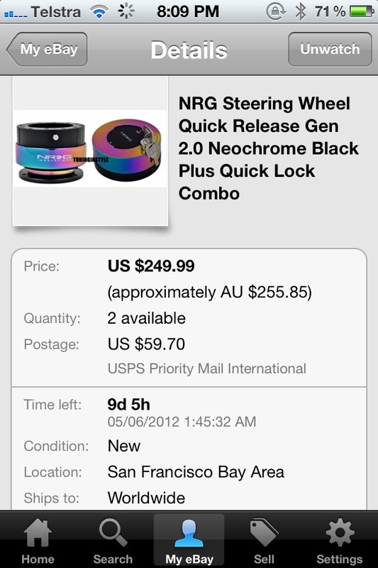

Can get Phil's quick release for under 150 on eBay I'm looking at getting one with a lock kit 290 shipped

yeah Phil bout the same I wasn't looking at getting the lock that's y so much cheaper
Decent boss kits??
2.0 version though

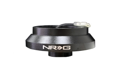

It doesn't show the hub adaptor, that you will need, it is the connection from the steering shaft spline to the quick release.
The short hub adaptor that you will need is SRK100H. http://www.ebay.com.au/itm/NRG-Steering ... 564a5a7b0a
You will find that the brass disc on the hub adaptor that contacts your springed horn connector from your steering shaft will be too small diameter.
To get mine to work I grabbed the springed horn connector with vice grips and bent it down about 10-15 degrees and then it made contact. :D
The insert of the quick release is bolted to the short hub adaptor

This is the Short Hub Adaptor that bolts to your stearing shaft and your nut that held your steering wheel on now holds this on. The bottom of the quick release bolts to this.

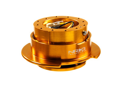

This is the quick release put together

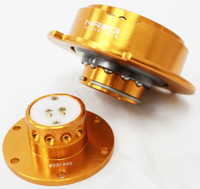

This is the quick release disconnected. The bottom piece bolts to the short hub adaptor and stays in your FTO always, the lock goes on here when your steering wheel is released. The top piece bolts to your after market steering wheel and comes out of your FTO with the steering wheel

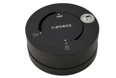

This is the lock that goes onto the bottom part of the quick release when your steering wheel has been removed
