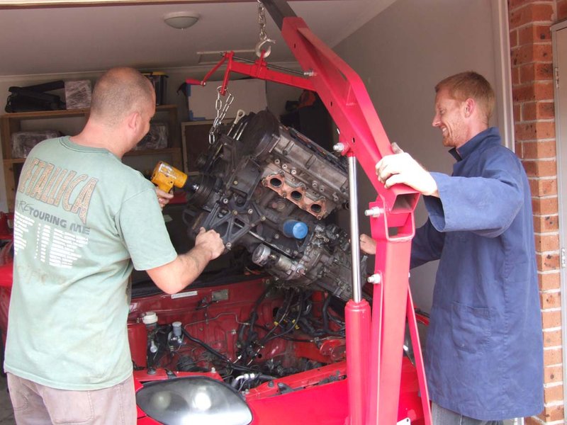

hmm, it's actually not that hard to get it in and out and back in again through the top, you need to get the angles right and you need the bonnet off but wasn't that hard, maybe an hours tops either way, and that's with only 2 people, me and the old man. As well as the engine crane you need a jack under the gearbox.

front and back on the engine only.
Re: engine and gearbox out,, help
I seen this pic today, thought it might help....
- DSCF1546.jpg (114.15 KiB) Viewed 380 times
Couple of good looking blokes there
