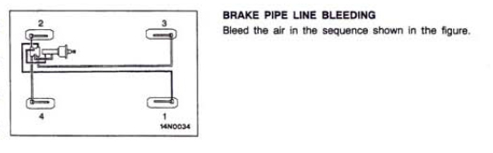

You have to keep the brake reservoir full of clean fluid during this process, don't let it go below the "MIN" mark. There is a bleed nipple on each caliper, the idea is to have a mate press down on the brake pedal as you slightly loosen the nipple, with a suitable hose pressed onto the nipple diverting the expelling old fluid into a container, you will then tighten the nipple before your mate releases the pedal, after tightening the nipple back up your mate will release the pedal then repeat over and over until the fluid comes out clean and bubble free. You need to do this on each caliper in this order RL-FR-RR-FL. when done pump up the brakes and check fluid level. You will be yelling to your mate "Pump-Release-Pump-Release-Pump-Release.........."

Caliper furthest away from reservoir should be bleed first. So RL, RR, FL, FRPHIL069 wrote:Is it worth getting my fuel injectors professionally cleaned? It wouldn't hurt, but I believe it's not too cheap, be a bit cheaper if you take out the injectors yourself and take them in.

The FTO has a diagonal split brake system as shown in the picture. The bleed procedure I mentioned is correct for this system.payaya wrote:Caliper furthest away from reservoir should be bleed first. So RL, RR, FL, FR

Correctomundo!PHIL069 wrote:The FTO has a diagonal split brake system as shown in the picture. The bleed procedure I mentioned is correct for this system.payaya wrote:Caliper furthest away from reservoir should be bleed first. So RL, RR, FL, FR![]()

Oh sh*t never knew! My bad!Shane001 wrote:Correctomundo!PHIL069 wrote:The FTO has a diagonal split brake system as shown in the picture. The bleed procedure I mentioned is correct for this system.payaya wrote:Caliper furthest away from reservoir should be bleed first. So RL, RR, FL, FR![]()
