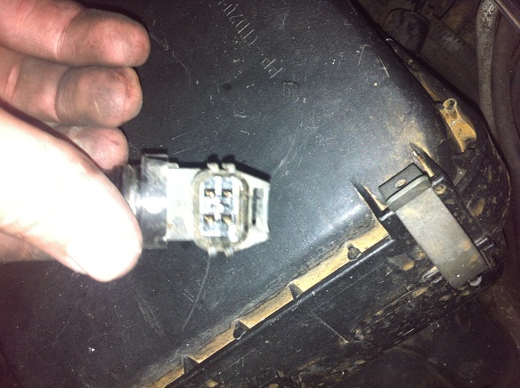

Input and output speed sensors come in a 3 pin or a 4 pin version. I have some 2nd hand 3 pin ones. I can also get both new if need be. From memory new ones are around $70 each.

    I think it's a four pin :/
    Here's a pic, i will need one asap !!! so i can sell and i don't want to rip someone off !!!! :)
    I am going to Sydney tomorrow if someone has on i'll be up there ? :)
    heres a pic of it
    heres a pic of it

    They are $80 new from Mitsubishi.
