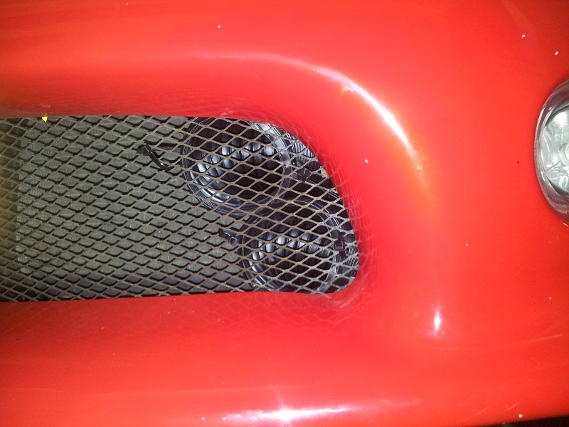

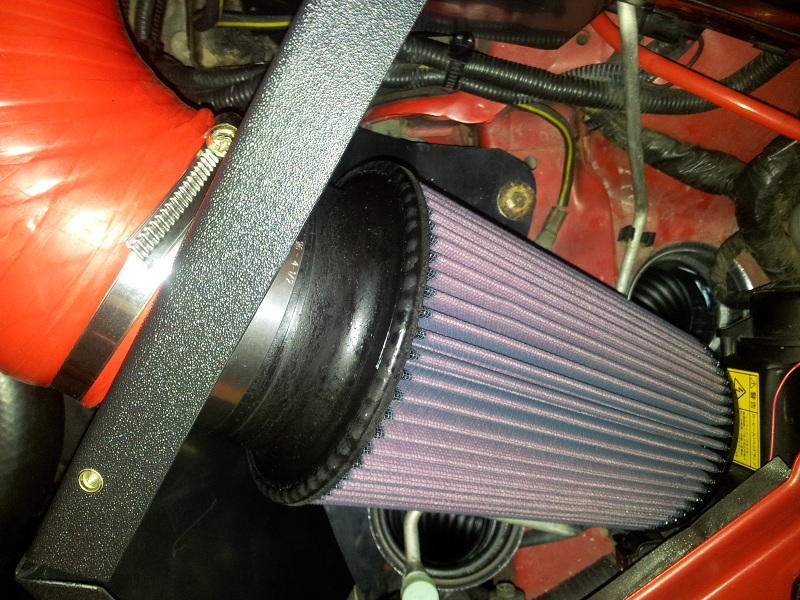

I've got two 3" flexi pipes running from the mesh in front of the radiator up to my UAS box.

Those pipes running around the radiator? Interesting... I couldn't find any space between the grill/radiator... hmm might have to look into it again. Could you give some more details on your mod please? :)

There is a thin plastic shroud between the front bumper and radiator that needs to be removed.
Not many more details really, UAS kit and 4" K&N pod.

Did you have to do any modifications to fit the 4" K&N on the UAS? Think the kit narrows down to a 3" filter? Also you can't have the 4" K&N inside the UAS box..can you?

shadowarrior wrote:Did you have to do any modifications to fit the 4" K&N on the UAS? Think the kit narrows down to a 3" filter? Also you can't have the 4" K&N inside the UAS box..can you?
I just had to get a 4" stainless pipe to go from the UAS pipe to the pod, and yes the 4" K&N fits in the UAS box.

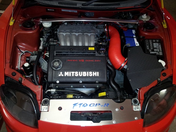

Hey vectose, do you have a 4-3" 90degree elbow reducer? Thinking about would seem as though thats the best way to speed up the air velocity right before the TB and is an off the shelf part from turbosmart etc.

I've got the UAS pipe.
