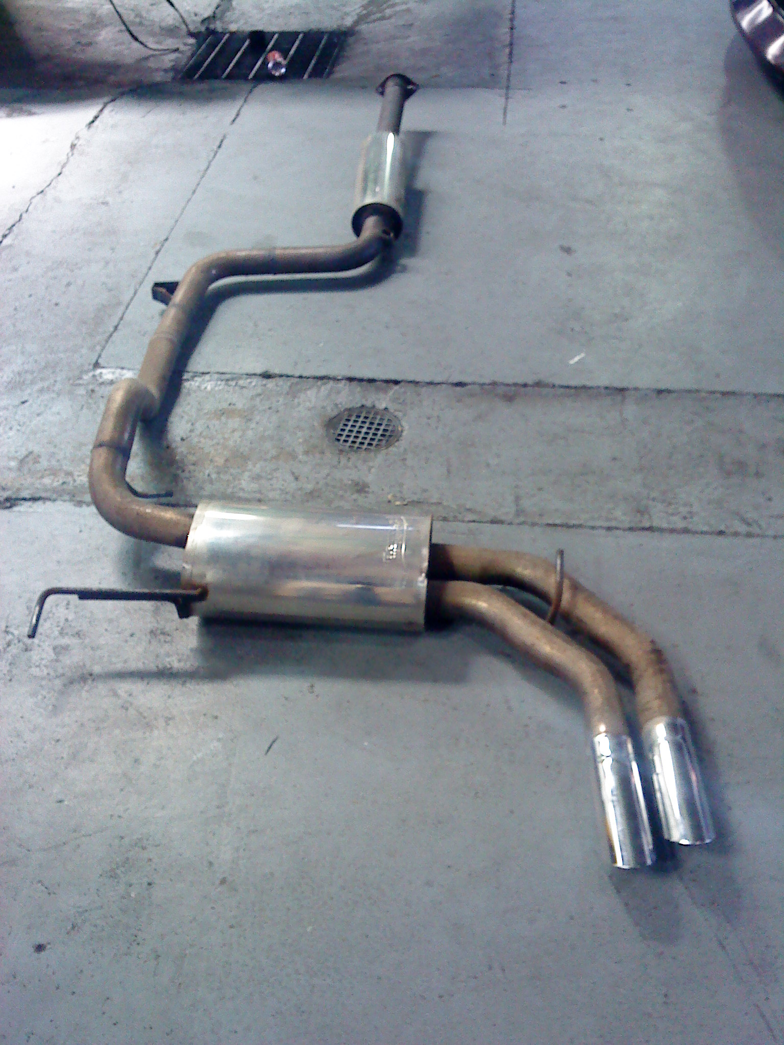

          Just replace it with 'normal' sports muffler. I can already see a resonator in the system in your pics.
          There's a bazillion brands you could use. Hightech, Magnaflow, Flow Master just to name a few.
          Here's a setup I used to use before going boosted. Its 2.5" with Hightech mufflers & resonator.

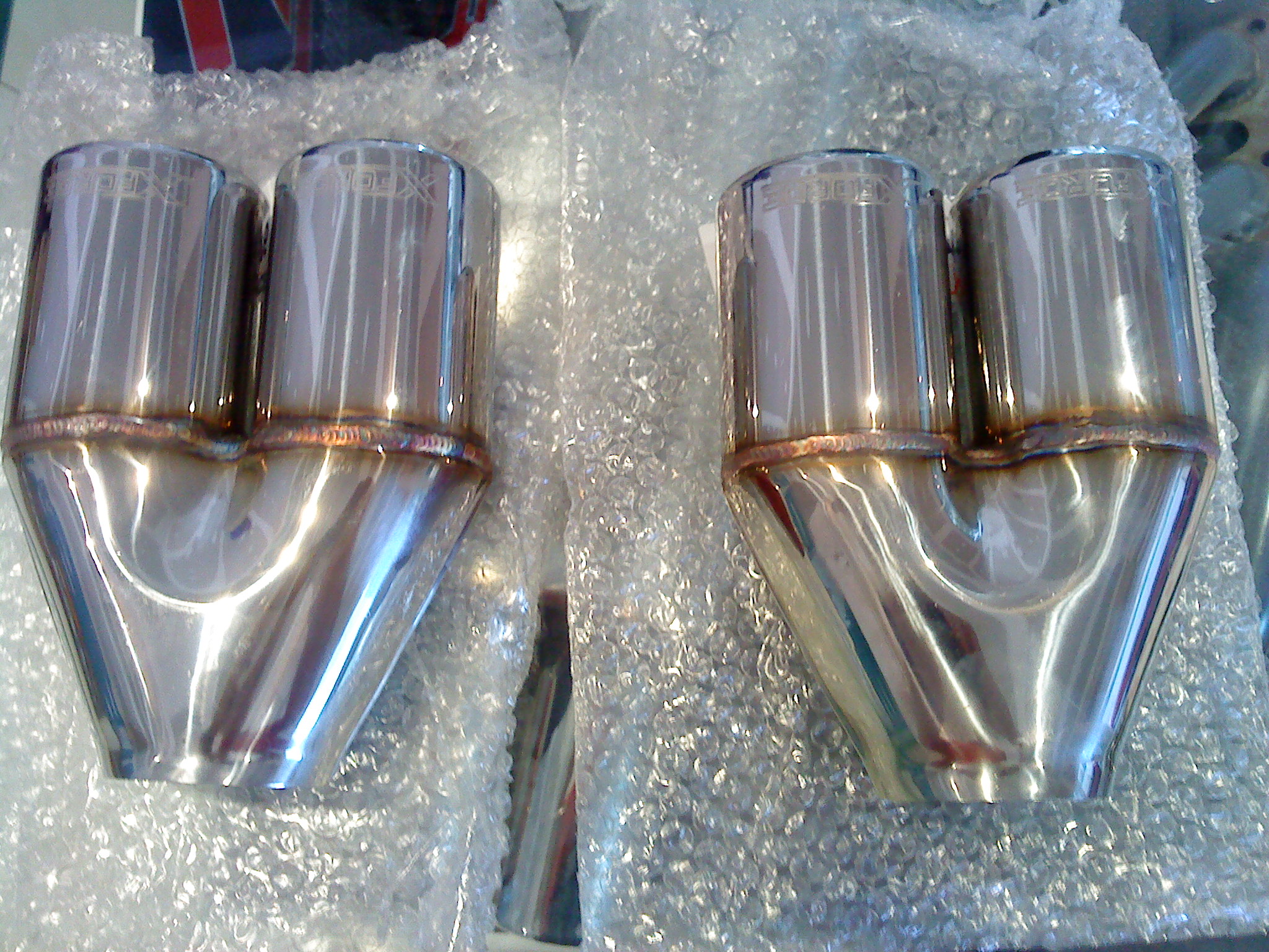

          And if its still too loud, you can use muffled tips, like these Magnaflow units
