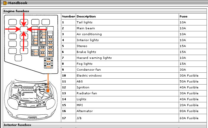

Another idea for your fan issue..........In the FTO engine bay fuse box there is a relay for the radiator fan, if this is faulty and sticking on when activated it would make the fan run constantly. Your fuse box may look different, but it still should have this relay.
In the picture I have pointed out the correct location for the FTO, it is known as.....A-57X Radiator Fan Relay

yeah i was thinking relays but might change them since im replacing radiator, with my car its :
the top 2 on the right are the radiator fans relays (lo & hi) and the bottom left is just the fuse, a bit different to the fto, but find it weird theres a hi & lo, but will replace them with different ones, hopefully all that does the trick.
Will let you know in a couple of days how it go's once i replaced all those stuff.
