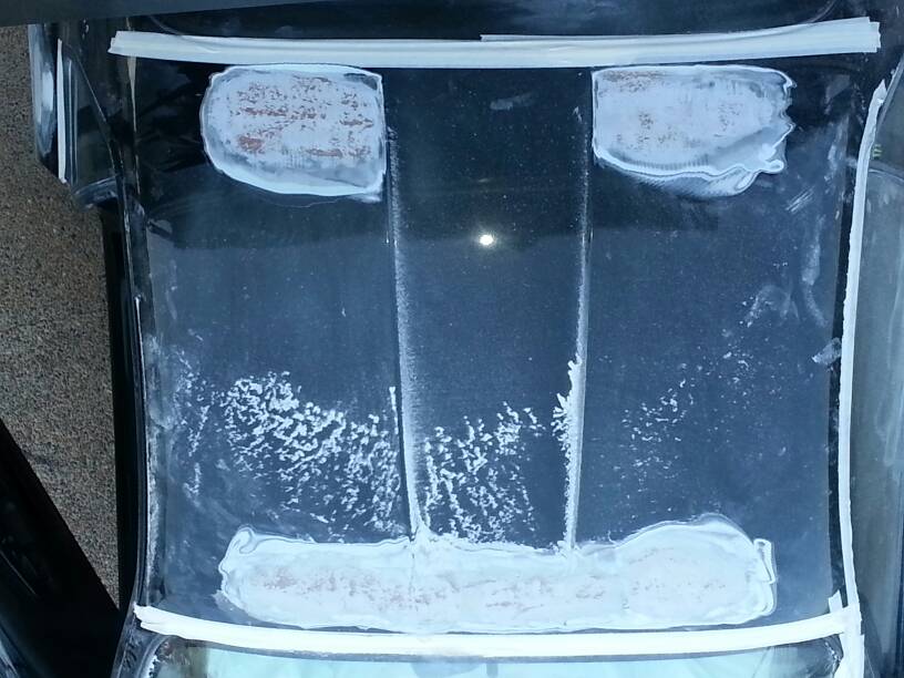

This is what mine looks like at the moment

    Too late my uncle already fiberglassed it for me lol

    The fiberglass is an ok TEMPORARY fix.
    Take note, as the inner frames not being cleaned properly and fresh metal being under neath that fiberglass it will rust again and be worse.
    The fiberglass is porous and will crack, allowing condensation to enter and rust the metal beneath.
    Fine for now, but I wouldn't leave it longer than 12 months without a proper fix.
    meanwhile, he did a decent job...

      Lol well he ground out as much as he could then used fiberglass bog to fill it because he said it's semi water proof and he used some stuff that is supposed to be really water resistant or something on the inside he said it will stop more moisture getting back in but he said it's only temporary as it will probably bubble back through in couple of years
