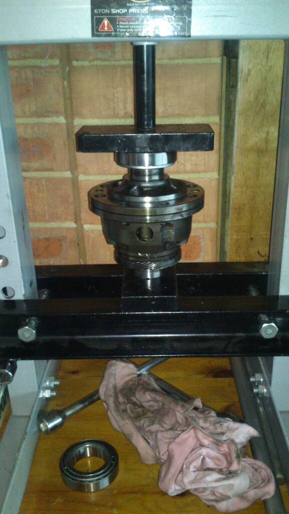

Yeah, I've done all the bearings on the input & output shafts now, just have to do the diff & shim it up & you can come get it. Should have time to finish it over the weekend
I've kept that f*cked one, so you can keep it as a souvenir!
Re: Gearbox & Clutch + Service
She's almost done mate, just gotta shim the diff & put her all back together

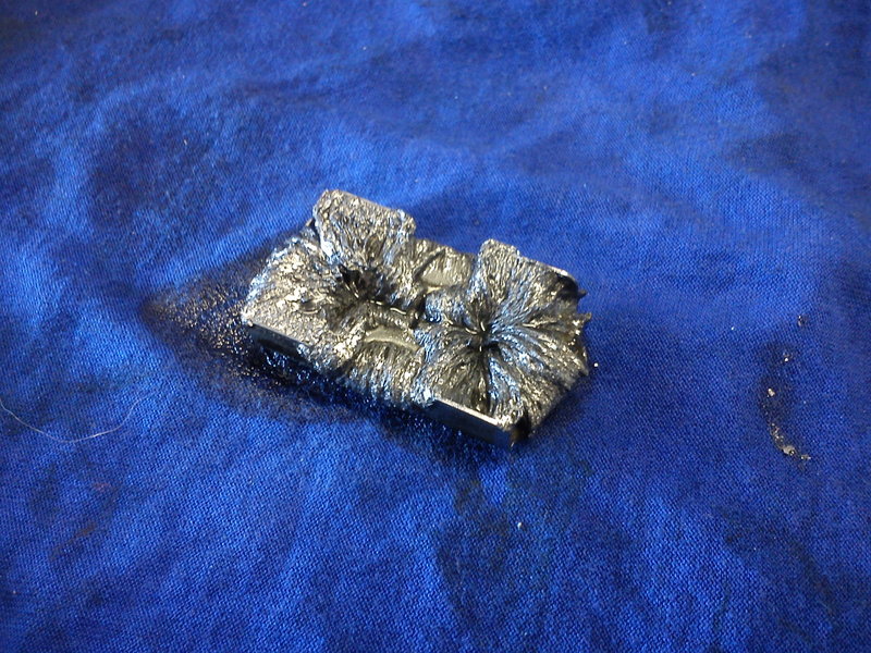

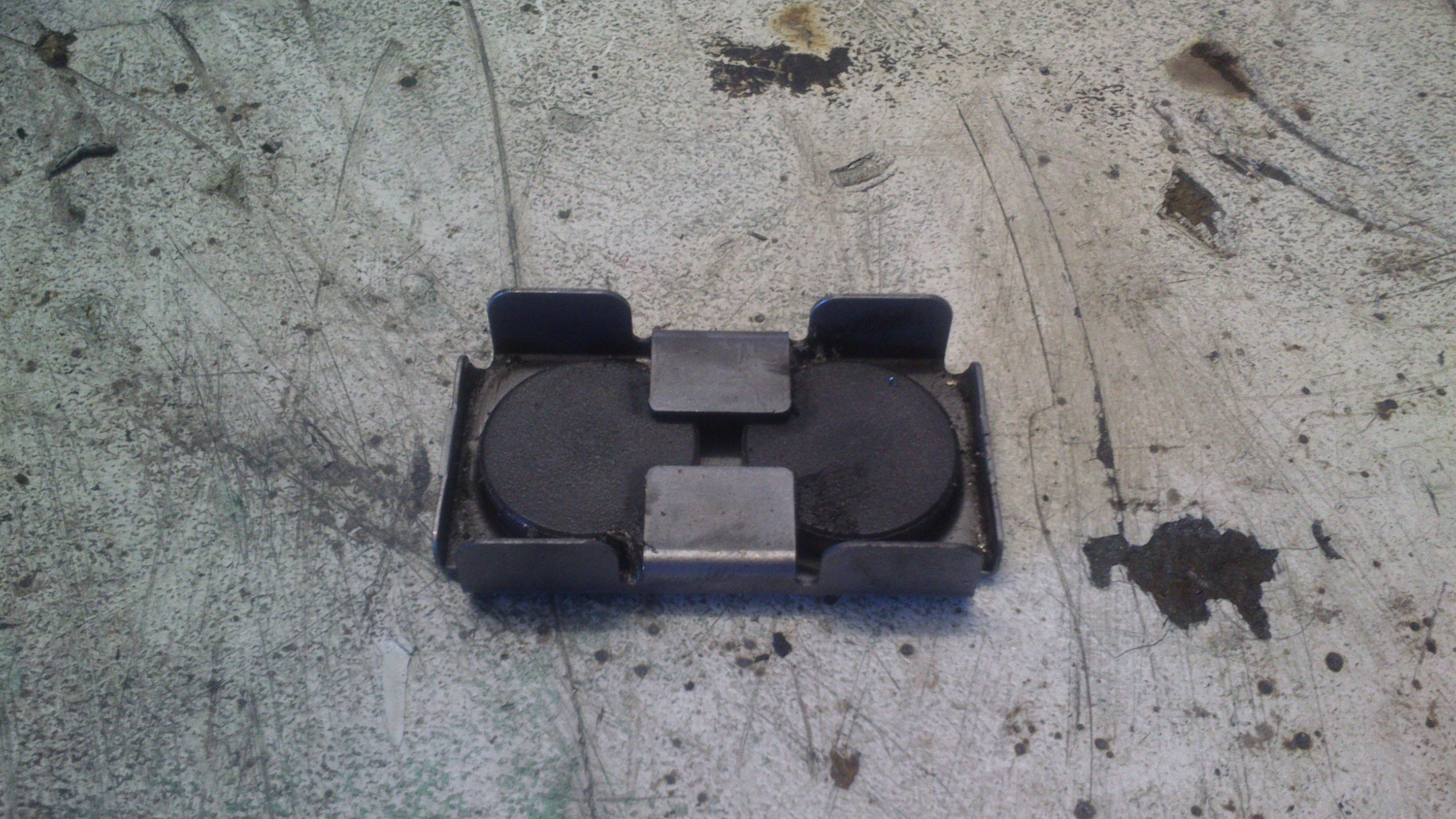

Forgot to put these 2 pics up. Relative to the fucked primary input bearing in the vid above, this is the magnetic collector found at the bottom of every box.
The top is what is meant to look like, the bottom is what Sivan's looked like after that bearing had almost collapsed....

sh*t that is bad, now interested to see how my one looks lol.
Holy crap
You should be able to remove this without taking box apart, for service inspection.
