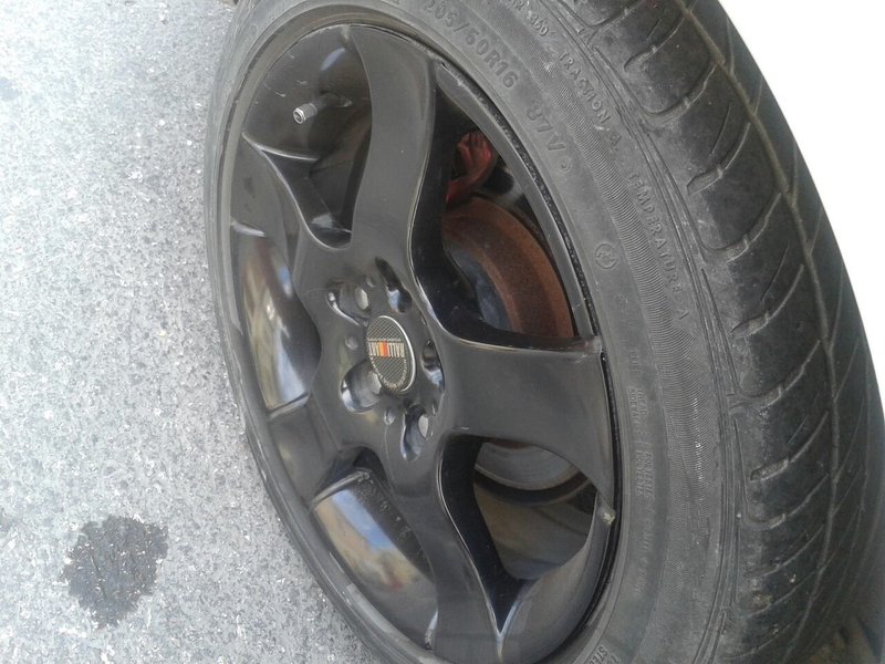

ok so today i finished installing the rear shock absorbers and i did not really like the way the rims look
any suggestions
should i keep the 16 inch do a bigger tyre such as 235 or 225 and add a small space of about 15 mm
Should i go for a 17 inch or 18 inch (i think i prefare 18 inch but i really want to keep the rims i have as they look awesome) besides the cost is too great to change them i dont have like 1.4k in euros to buy a complete set so any website suggestions would be nice.
ok ok so dont look at the disk brake here its the before pic :P

sorry to sound so noob but whats the offset...
im currently looking in buying the same rims i have at 18 x 8 with 235x 35 ....will this be solved with say a 10mm spacer?

You need to find out the offset. We can't tell you until you have it.
This is what offset is:
http://www.tirerack.com/wheels/tech/tec ... techid=101

Post by Ephercius »
mhhhhh :?: :?: :?: :?: :?:
so basically i have to buy the rim first then i have to find out what it is?? bleh that sucks....
supplier i found it from suggested spacers or fender modification :drunken: if i want to put 235 tyres on the rim
Re: 16 inch 17 inch or 18 inch???
Ephercius wrote:mhhhhh :?: :?: :?: :?: :?:
I think what Bennoz meant is that we can't tell you if it will fit without knowing the offset of the rim.

Not 100% correct all comes down to offset if supplier can't give u that info i wouldn't get them

ok so i asked them again what the offset is and they said its 40
If + 40 which it probably is stay away u don't really want to go over +25 I think unless u get spacers
