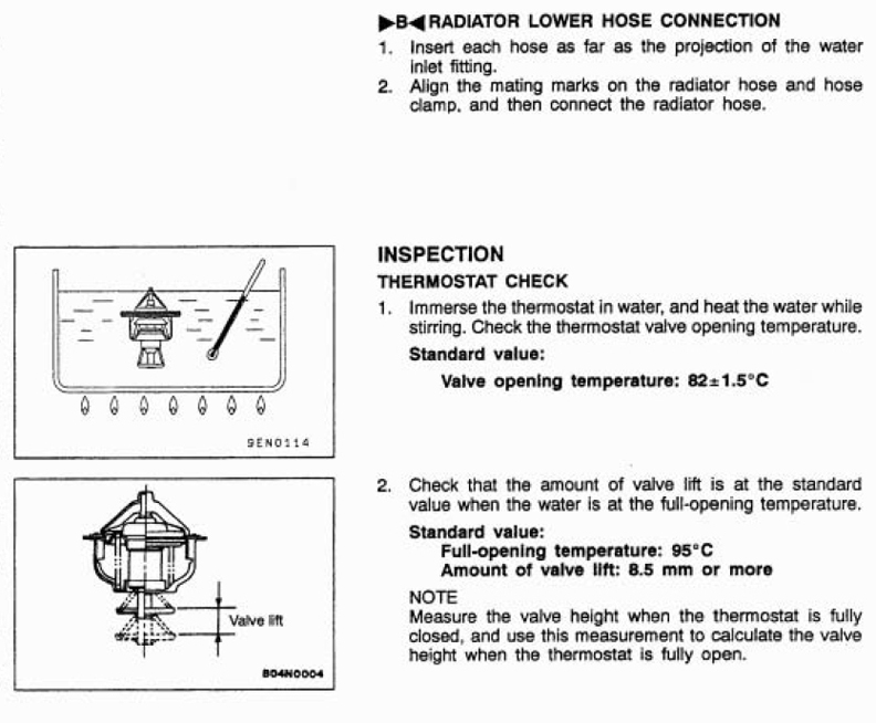

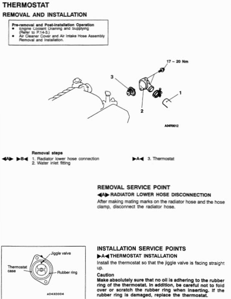

Howdy, can somebody post a pic of where the thermostat is? I've found a few posts describing, but would like to be sure before a friend and I replace it.

Follow the lower radiator hose to where it attaches to the engine. The dome shaped bit next to where it joins is where the thermostat is. Should be 2 x 12mm bolts (I think).

    I think we were looking in the right spot before, but weren't sure. So it's not the one right below the radiator cap, but to the right of that?
    Re: Thermostat Location
    This might help...

    Phil to the rescue, and even taught me something new for later knowledge :lol:
    Phil you are a legend. Cheers! :thumleft:
    Wayyyy better than I was going to be able to do. Thanks Phil.
