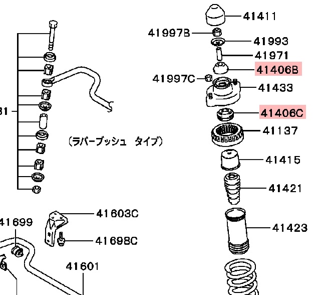

Just wondering if anyone had a part number for the rubber bush that sits on top of the rear shock? Preferably poly. The suspension thread hurts my eyes. All 26 pages of it.
Cheers.

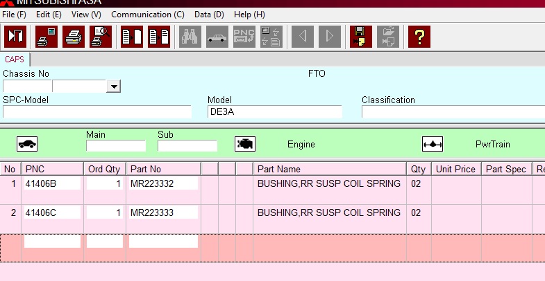

Awww, TDLR?
Guess what, I just had to read it to get your part numbers :lol:
No such thing as poly, only oem rubber. There are 2 bushes there, your replace one, you should be replacing the other. Amayama would be your best best short of going to a Mitsi dealer.
