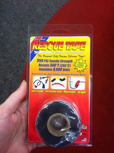

Lol, just stumbled upon this sitting 2 desks behind me.
Re: Engine Bay Materials?
Astron_Boy wrote:Lol, just stumbled upon this sitting 2 desks behind me.
Use this when out motorbike riding, great for split radiator hoses etc.
Only water cooled bike I've owned was my CBR. I always buy Aircooled, but not a bad idea.
Even 4x4ing, never know when a branch decides to shoot up in-between the engine guard.
Mainly dirt bikes, used it a few times on tyres then just filled it up with co2 bottle
