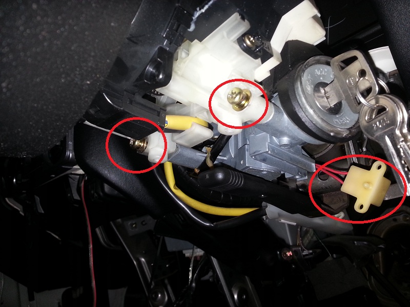

Started to take it out and now im stuck.
I need to remove just the barrel, or as little as possible to do with it so i have a working lock with the GPR key.
It seems im stuck on these two...fasteners?
They dont have anything to just unscrew out etc kind of like a rivet. How do these come out? Are they necessary to just get the barrel out?

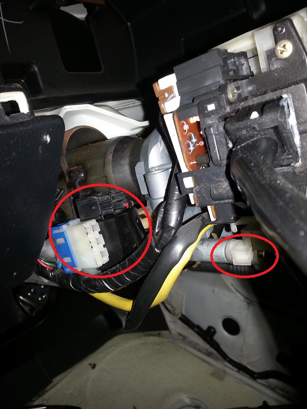

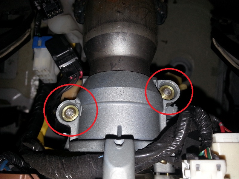

Ive removed something attached to the barrel, little plastic box, and two screws which also hold the assembly to the column.
Also taken out the two plugs which seem to be attached to the whole assembly too.
It doesnt look like there is anything else i can unscrew/bolt or take out but its still solid in there, and by the looks my problem is the first picture - they just dont seem to want to come out.
Can someone please point me in the right direction!

Just removed it! :cheers:
Theres a tiny hole by the back of the barrel on the outside, on the first picture, the middle red circle, about there. You need to insert a tiny allen key in put the key in and while holding pressure on the allen key turn and pull - slides right out 8)
