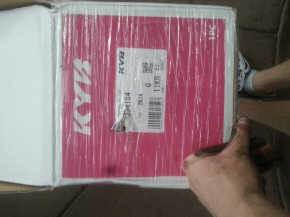

I did the search and understood that that front left ie passengers side was 334154.
Ordered it from car parts australia and the box is a brand new 334154 but the brake line holder is on the opposite side same with the abs. The 334154 is identical to the drivers side but I thought the drivers side was front right ie 334155???

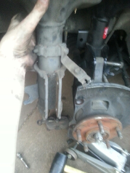

From the picture it's installed correctly.
The seat for the coil will be sitting cabin side mostly, which in that picture, it is!
Odd.

The actual struts are identical, the only difference is the location of the abs sensor lines and the brake hose holders.
Various people have quoted the wrong part numbers. ...
Taz wrote:All taken from posts from our mighty GOD AND SAVIOR Bennoz
Shocks - 4 x KYB Gas
Part numbers; Front L: 334154 Front R: 334155 Rears: 341140
dstocks wrote:4 x KYB Gas Part numbers; Front L: 334154 Front R: 334155 Rears: 341140
Fronts are same as a Volvo S40. Most places stock them
bass_twitch wrote:KYB Shocks:
Front L: 334154
Front R: 334155
Rears: 341140
Lovell Lowered Springs:
Fronts: CFL-45
Rears: HRL-49
and so on. Might be worthwhile editing them :lol:
The other side was ordered today so both get changed lol

Shhtuart wrote:The actual struts are identical, the only difference is the location of the abs sensor lines and the brake hose holders.
Huh!
From quick inspection doing the control arm couple of weeks back it looked as though the strut top bases favored one side. *shrug*
Re: Front left strut 334154?????
I'll be pulling them out again this weekend so I'll post up comparative pics.
