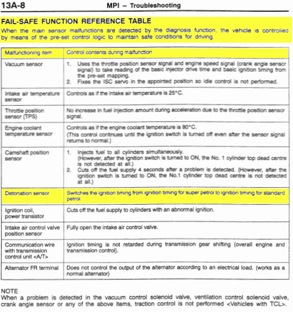

The FTO engine is designed to run on "Super" fuel ie 98-100 octane. The ecu will detect you are using a "standard" fuel ie 91-95 octane via the detonation sensor and de-rate the engine.
If the detonation sensor fails the ecu will de-rate the engine to standard fuel timing as well.
So if you are using "standard" fuel you might as well just unplug your detonation sensor and perminatly de-rate your engine.
FYI, the 100 octane fuel available in Australia is not really a 100 octane fuel, it is 95 octane fuel with an additive to make it burn at 100 octane, the additive evaporates quicker than the fuel, by the time you pump it into your fuel tank it is already back to 95 octane. Waste of money.
Do your FTO a favour, get the correct timing out of your ecu, get the best l/km, use 98 octane.
