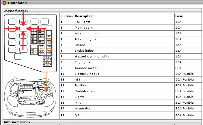

Might be your fan relay in the engine bay fuse box.
Try swapping #13 Radiator fan relay with #10 electric window relay just to test. Both these relays are the same.
If it fixes your problem then just leave the window one empty until you replace it.

Re: Fans not always working
Sorry wrong pic, you need to swap this one over with maybe a spare one from your spare car...
Relay Radiator Fan.jpg (133.07 KiB) Viewed 1108 times
Now all the "brown" relays are the same in that row but I'm unsure what the rest are so better off getting another to test with.
You can still swap the fuses as stated before too.

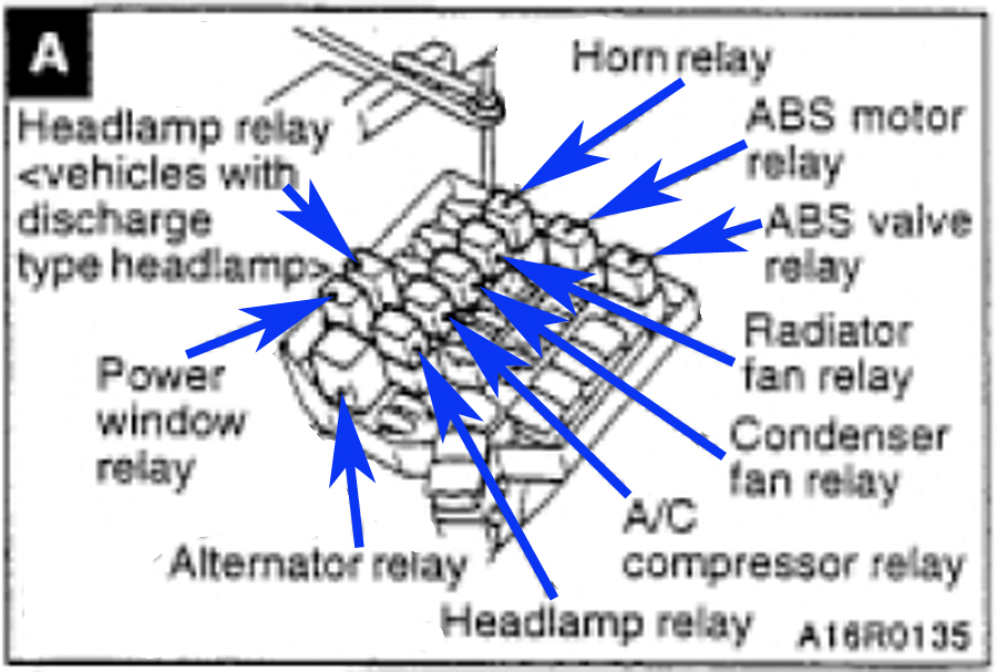

Wait what's that second one inside the arrows for?
Daniel2019 wrote:Wait what's that second one inside the arrows for?
I have made up a pic naming all the engine bay relays.
I would swap the radiator fan relay with the horn relay and test your fans.
Forget all that I previously said :lol:
So swap the top two?
Good thinking!
Changed relays, still not working. Next idea!
