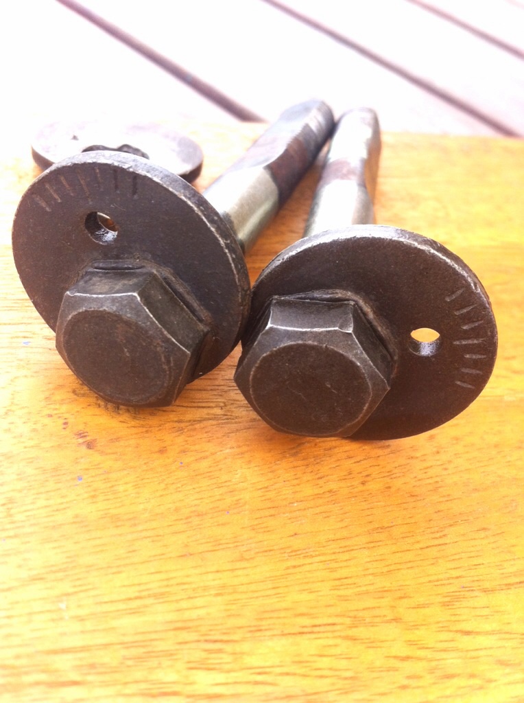

So I was pulling apart my rear suspension and everything was going smoothly.
I got to one of the camber alignment bolts and the f**ker wont come out. It is seized to the crush tube of the bush.
And to make matters worse the bush is torn and the whole crush tube spins with the bolt.
Tried putting some vice grips around the crush tube to try and crack it but have had no success.
Any tips before I take an angle grinder to the bolt and drill it out?

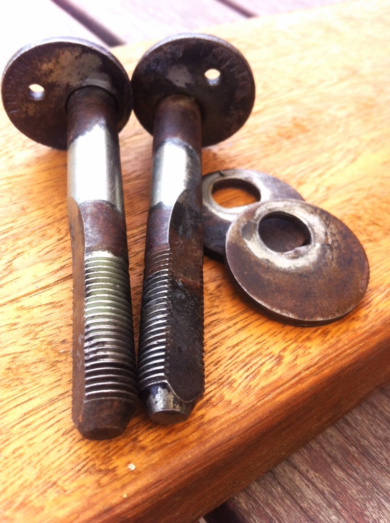

    Got a reciprocating saw from bunnings for $45 :cheers:
    Cut the bolt out. Had a bit of trouble with one of the toe adjustment bolts, But managed to hammer it out.
    Will need some new bolts as pretty much all of them are rusted up pretty badly.

      I didn't get the bolt out. It is still stuck in the control arm bush sleeve.
      I cut it on both sides between the chassis and control arm so that the control arm just drops out.
