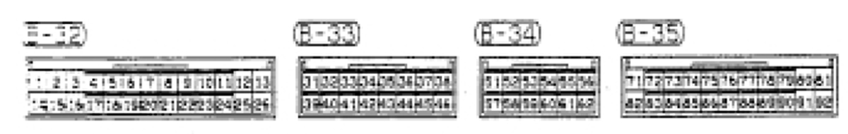

Hey all,
So we're trying to work out the wiring diagram for the ECU.
Is this diagram looking at the harness or at the ecu itself?
We're pretty sure it's looking at the harness, but want to confirm...
Re: ECU Wiring diagram
It states above the listing for #1...
"viewed as your looking at the ECU pins top side up"
So it's looking at the ECU pins not the harness
This is looking at the ECU as printed in the electrical manual, it is the same as your pic

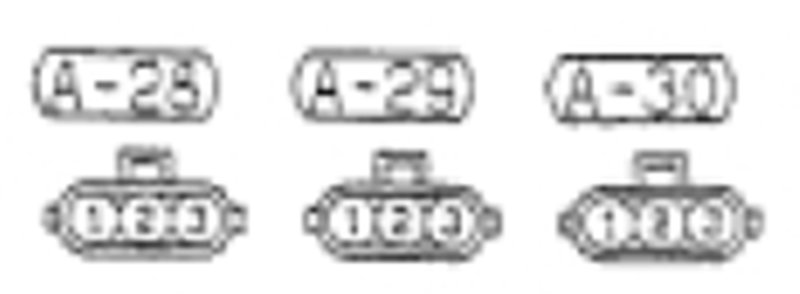

This pic is of the ignition coil in the electical manual

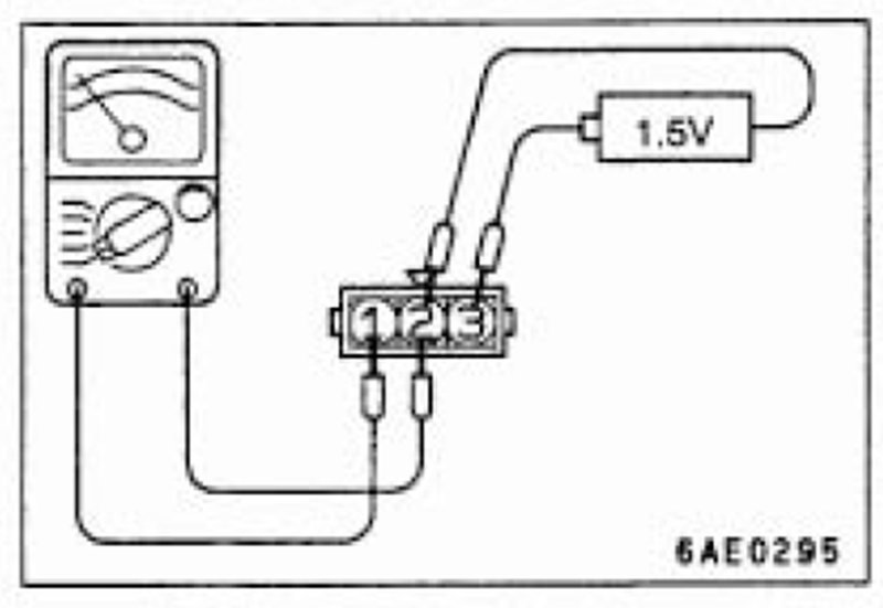

This pic is looking at the ignition coil in the workshop manual
This shows that the electrical manual diagrams are looking at the units not the harness...So your pic is looking at the ECU!
Sweet, thanks. It was kind of confusing the way they mentioned it...
So confirming, it would be as if you're looking at the back of the wiring plugs?
