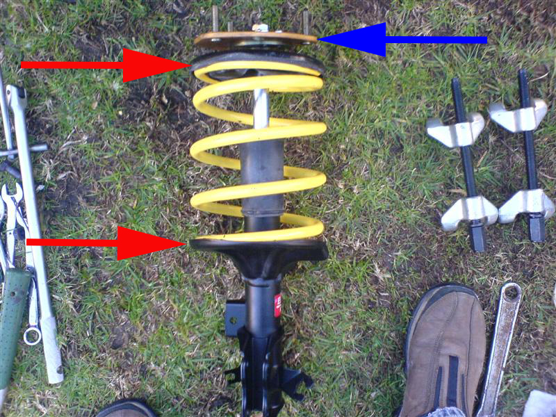

In the following pic you will see 2 red arrows pointing at holes in the upper and lower spring cradles, these 2 holes need to line up one directly above the other.
You will note that I pointed out 2 moar holes in the upper cradle with blue arrows, you have to make sure you don't line these 2 up with the lower hole.
If these holes aren't lined up then the springs can move within the cradles making rattling/cracking metal to metal noise, it is also possable to feel the spring moving from your steering wheel.

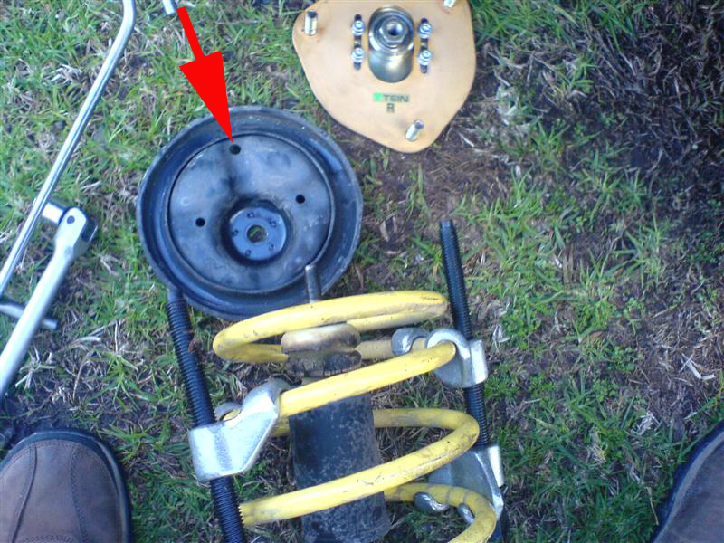

Yeah i can feel this, but mine look really different to those :\
This probably means nothing, and ignore the arrow in the pic. they've moved them quiet far from where they were and looked like they went at it with a screw driver and sorta damaged (Light) the tops. but if you can see anything that isn't right! let me know.
This is Fulcrum btw. woulda thought they were pretty good :|

The part I'm showing you in my pic is further down the strut, under the pillow mount and under the wheel arch. On top and bottom of the spring.
BTW, mine were put back together by Fulcrum too. :roll:

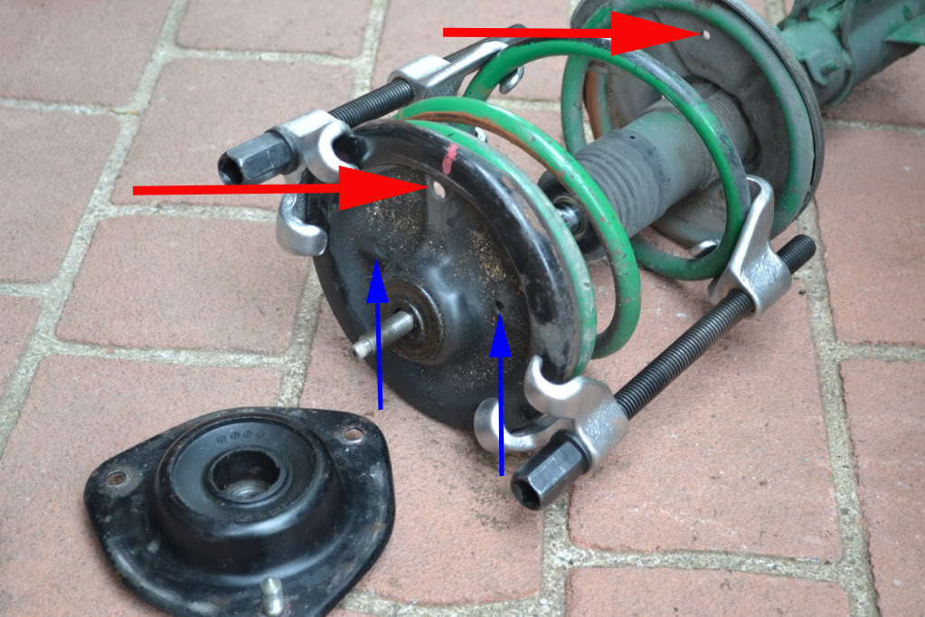

Here are some pics of Bennoz's struts with pillow mounts.
The red arrows in this one points to the cradles that need to be lined up and the blue arrow points to the pillow mount that you can see in your pics.
As you can see the spring cradle is below the pillow mount
This pic again shows the hole that needs to be lined up with the hole in the lower spring cradle...
Re: BC V1 PillowBall Upper Mount + More
This might not be your issue but it is worth a look, just in case. :D
