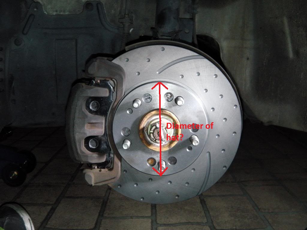

also - does anyone know what the diameter of the hat is? the twin-pot frame may well hit the hat on the single pot disks

Re: GPX twin pot brakes
I can get you that measurement while I try to figure out how to get that cross threaded axle nut out
Will update over the weekend.
Yep it's a 96 GPX.
Wouldn't mind an extra hand
Do you want to come over tomorrow? You can have a look at the brakes in person then?
