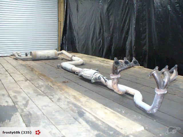

Are these aftermarket headers?
Does this exhaust/headers look stock or aftermarket to you?
The whole exhaust looks stock to me, except it's advertised as 2 3/4" aftermarket exhaust, and they're asking $1K...
Re: Are these aftermarket headers?
The headers don't look like factory exhaust manifolds, they look like headers/extractors.
The center section and y-pipe look aftermarket.
The back section looks like stock.
But I don't have stock so I have nothing to compare it too really.
Post by c0n13oX »
Looks thicker than mine from headers to just after cat and mines stock size
This ^^.
Stock headers will be a rusty colour as they are cast and the y pipe will normally have a steel woven section and that does not.
        Just saying, dont go off the color of them. My standard ones are polished. But yeah theyre aftermarket.
        Post by Nacho »
        PHIL069 wrote:The headers don't look like factory exhaust manifolds, they look like headers/extractors.
        +1 This y pipe is one of the better flowing ones.......stock fto exhaust gases meet at an intersection but these flow in the same direction
