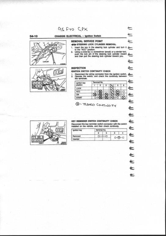

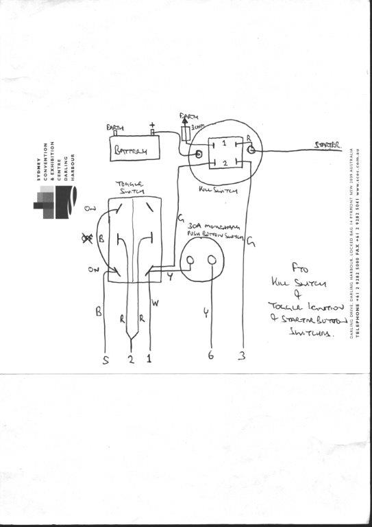

For those of you that want to go hard core :twisted:
Disclaimers:
This is not street legal. Requires removal of your existing keyed ignition switch.
This is not fully tested. I never did get around to removing the keyed ignition switch lol.
Only the Kill Switch component of the wiring is tested. But the rest should work... :twisted:
Grr, can't upload PDF. Ben are you able to link a pdf if I email it to you? jpegs will have to do lol.
95 GPX Ignition Starter and Kill Switch Wiring1.jpg (42.09 KiB) Viewed 1986 times
95 GPX Ignition Starter and Kill Switch Wiring2.jpg (32.47 KiB) Viewed 1986 times
