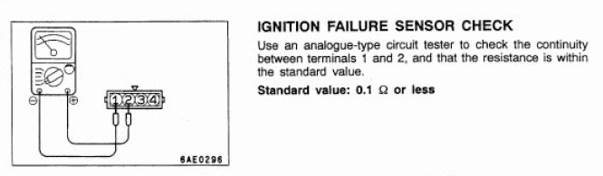

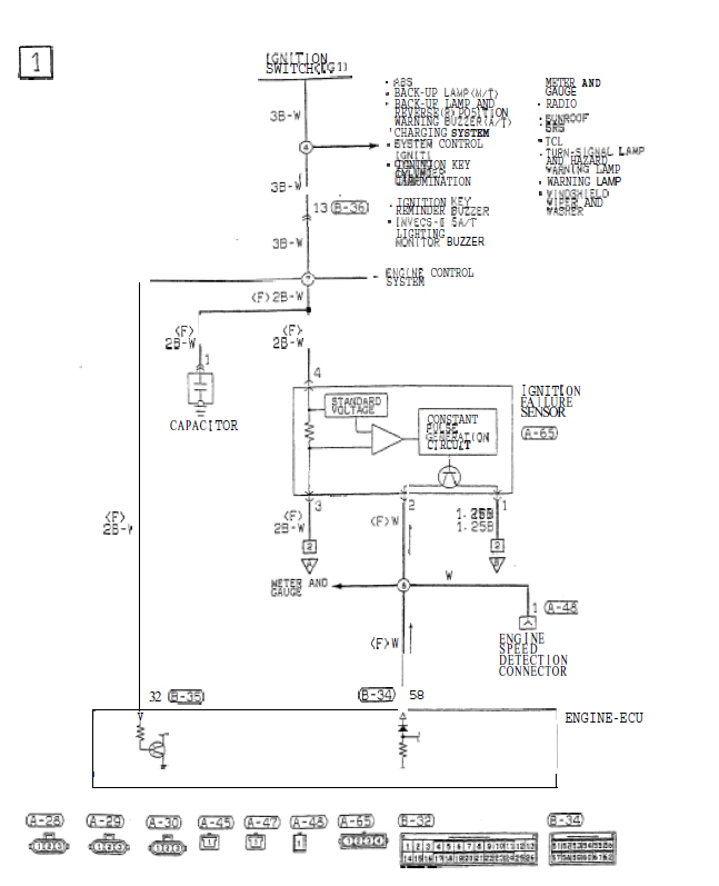

Here is some info.
If you can read wiring diagrams you should be able to work out if the IFS is getting the correct signals from the harness.
IFS 01.jpg (63.37 KiB) Viewed 548 times
IFS 02.jpg (58.22 KiB) Viewed 548 times
IFS 03.jpg (184.79 KiB) Viewed 548 times
