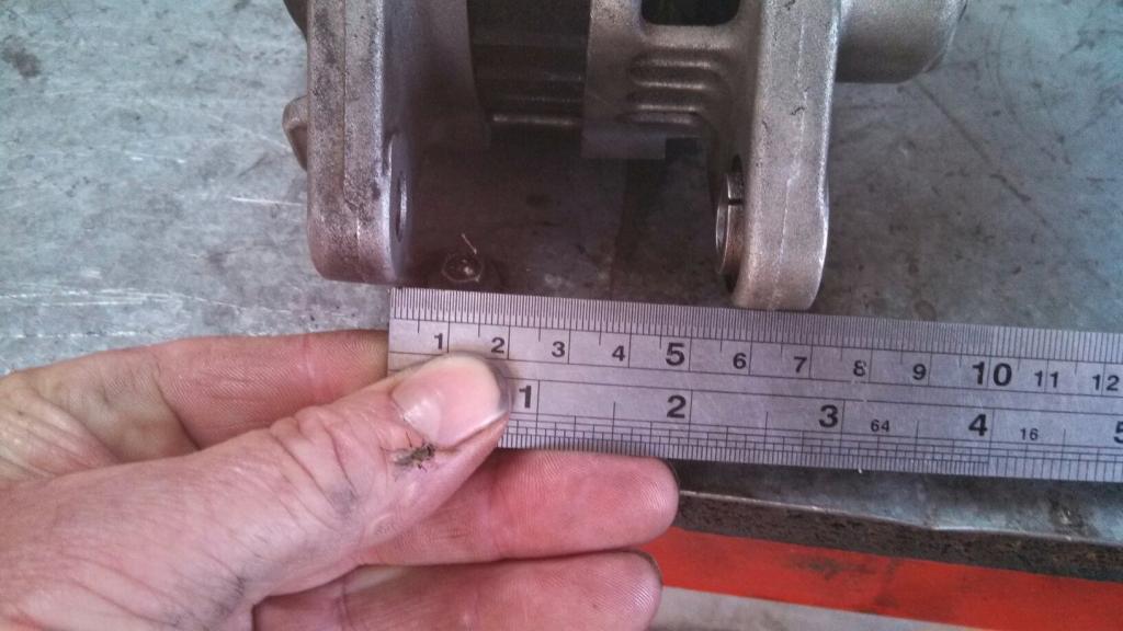

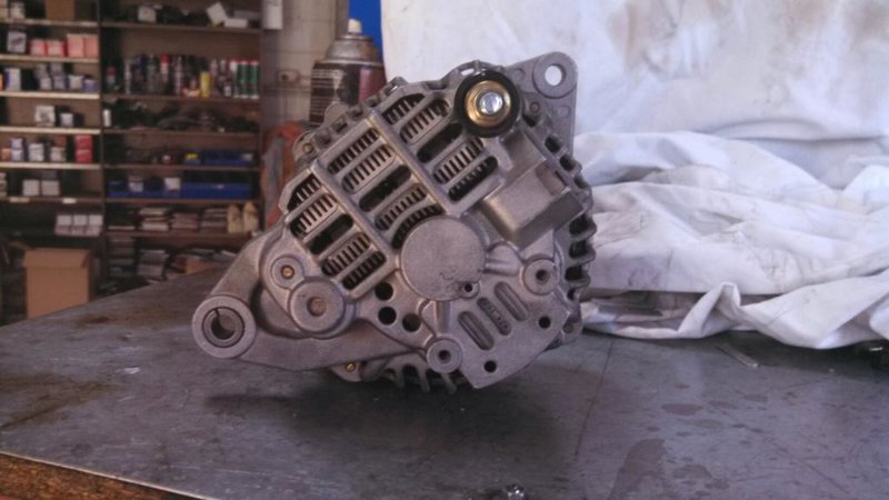

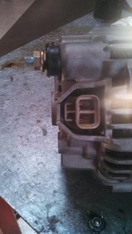

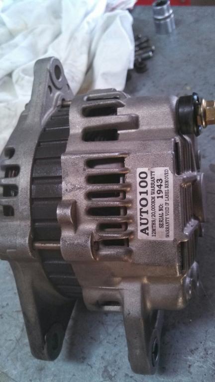

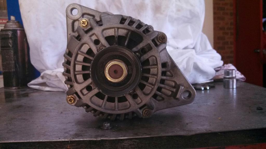

KatVIC
Posts: 11
Joined: Tue Dec 09, 2014 4:47 pm
Re: Alternator confusion
Post by KatVIC »
Hope this works pics of what was taken out
