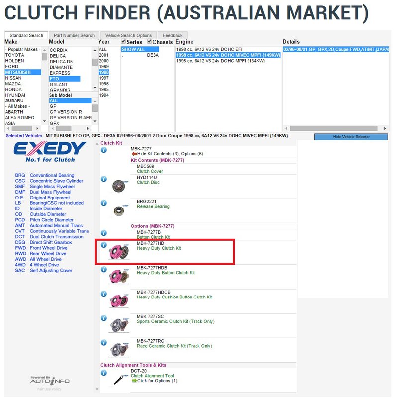

If I do need to get a new clutch does everyone agree that the Exedy Heavy Duty are the best? (http://www.exedy.com.au/clutch-finder-nz)

WOHOOOOO!!! Exedy Clutch Kit (NMK7277HD) Heavy duty for NZD$389 SO CHEAP!!!!!! So happy
