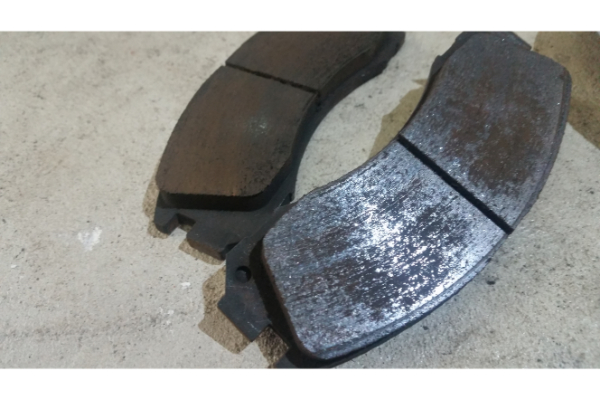

The paint made the caliper hard to get off, i hope you dont mind if put a couple of photos up of the pads

The pads look OK actually. And plenty of pad left, so no issue there. Id put them back in and go for another drive. Make sure the bolts hold it on are tight. See if the noise comes back and make sure it goes away when you stop the car with the engine running.

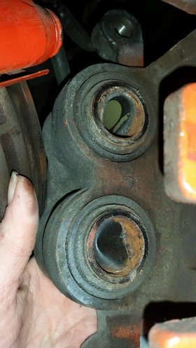

Ok, so i noticed there was a lot of break dust and gave it all a good cleen went to put it all back on and the two piston thingys dont look so good

The rubber seals around the pistons look OK. The outside surface of the pistons doesnt matter. Its the piston walls that need to be in good condition and without removing them (which I wouldnt advise), you wont be able to tell that. Press the pistons as much as you can before replacing the pads. That will make it easier to fit the caliper back on the disc.
