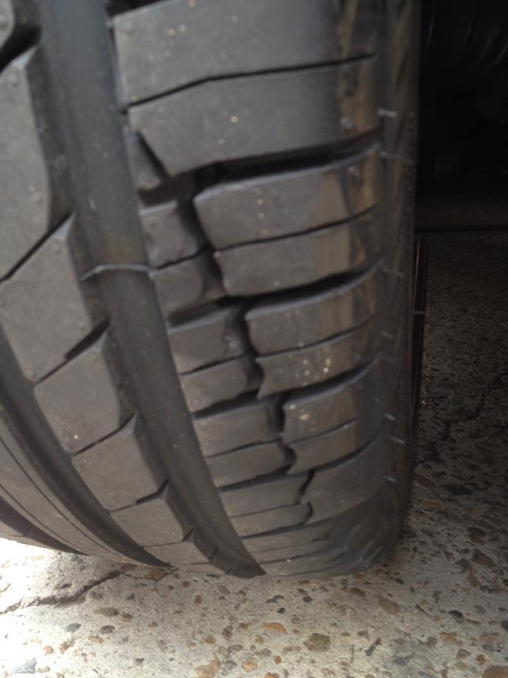

Here is what happened when I tried to do a full-clock with 235/40ZR18.

Looks like someone didn't lump hammer out the wheel arch seam. :lol:
Re: Wheels too wide?
Yup, lump hammer and/or cut and weld the seam.
Had to do that on mine and it fixed all my issues.

Funny thing I had same size tyres since 2008 but this only happened when new tyres were put in 2012. Then the guy from tyre shop charged me another $150 for a new tyre and used sledgehammer to flatten the arch seam 8-O
Might've been variations in brands perhaps.
bjk wrote:Might've been variations in brands perhaps.
Yeah, but that's a pretty deep gouge. Brand variation wouldn't be that much.
Oh well, extra tread.
Make sure you make the seam look legit after though. As its for crash purposes and might cause you not to get a payout on insurance
