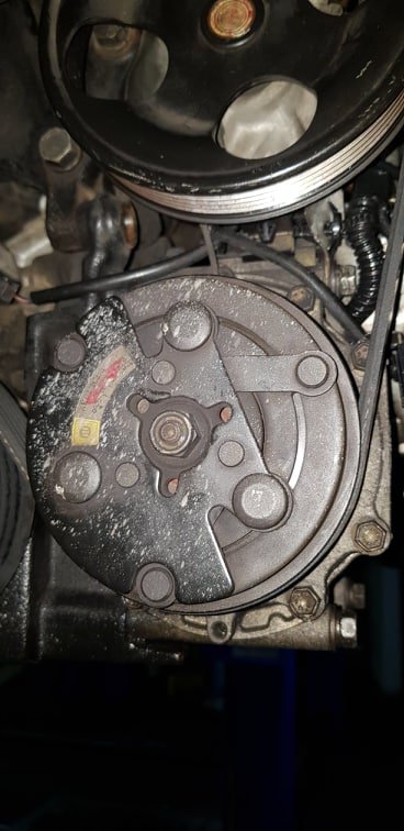

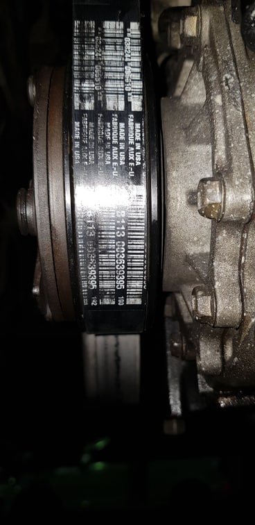

Hi Guys,
Trying to find the exact part number so I can order a new / replacement front AC Compressor pulley.
The bearings on mine are shot to sh*t, yet the compressor works just fine.
If anyone knows or can assist that would be fantastic.
1996 Mitsubishi FTO MIVEC 2.0L engine.
This is the best I could find:
Model: MSC90C
Serial#: 0009855
Part: AKC201A203A
I can not seem to find one of these anywhere though, hence my issue.
Only the actual pulley is required. Not the entire system.

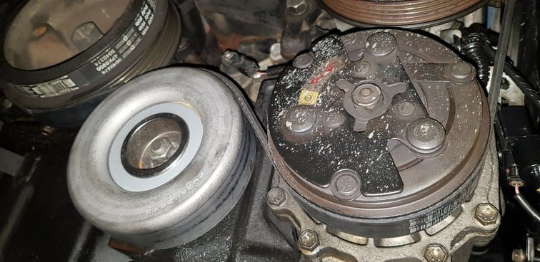

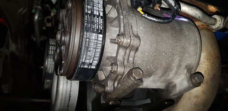

Re: FTO AC COMPRESSOR PULLEY BEARING
Images attached.
Do you mean the tensioner pulley?
If so, part number is MD366344
You can purchase it from here or give Mitsubishi spare parts a call:
https://www.amayama.com/en/part/mitsubishi/md366344
Thanks Spetz, its the front pulley connected to the AC Compressor, the bearings are shot to sh*t.
Different to what you have stated.
I may need to get another compressor but given the age of the car Im concerned I will end up with another lemon.
Any suggestions would be greatly appreciated.

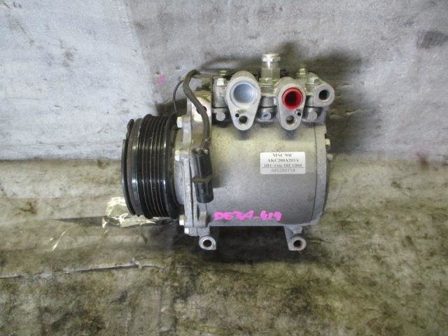

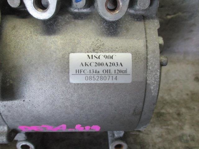

DE3A AKC200A203A
- PA01623691_612bd8.jpg (53.9 KiB) Viewed 10159 times
- PA01623691_4774d6.jpg (47.65 KiB) Viewed 10159 times
