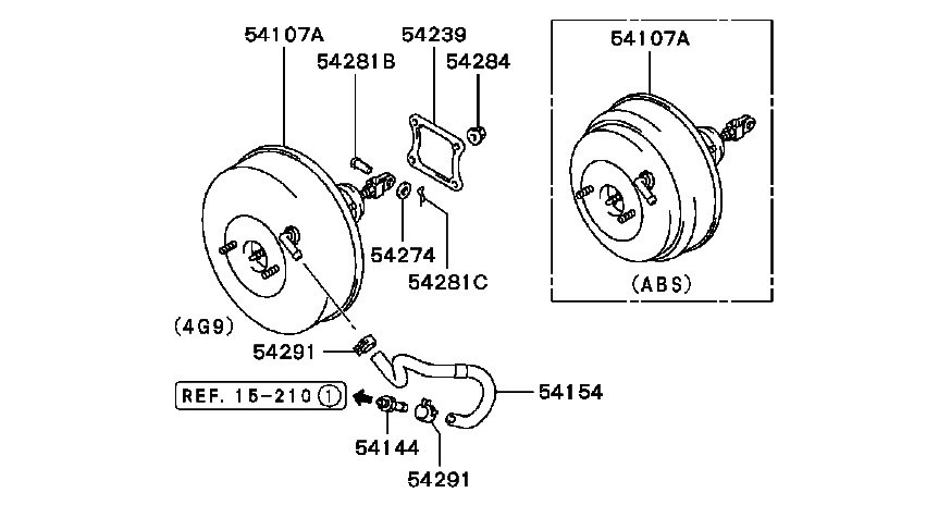

That could just be your missing the relay mate.
Bang on a pic of your brake booster and have a look down near the battery tray / firewall for the abs valve block thingy.
Rob Furniss
Posts: 1394
Location: Perth
Re: Replacement rear bearing advice needed!
Post by Rob Furniss »
Here's a pic of the different brake boosters, ABS one is larger and has like a double hump
FTO Brake booster - standard and ABS.jpg (50.68 KiB) Viewed 6983 times

Cheers for that Rob. So I got my rear hub bearing changed today. It turns out I don't have ABS. I bought two hubs as I didn't know what would fit. The non-ABS fitted... Sent the ABS one back today. I was just about to buy the relays and fuse. I'm a bit disappointed it doesn't have ABS!
