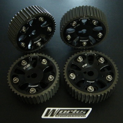

This is the stock pic of them.
- $(KGrHqZHJCQE7yy+2m3JBPFZ)emDEw~~60_12.JPG (50.31 KiB) Viewed 1240 times

Just an update, for anyone considering these, they have the sensor plate on one of the cam gears, suitable for the mivec motor. (Not sure if that sensor/plate is specific to the mivec motor or not)

Re: WTB: Cam gears 6A12 mivec
What ECU are you using? I run a Haltech & we just ground 3 out of the 4 tabs off it & it worked a treat.clint111 wrote:Just an update, for anyone considering these, they have the sensor plate on one of the cam gears, suitable for the mivec motor. (Not sure if that sensor/plate is specific to the mivec motor or not)
