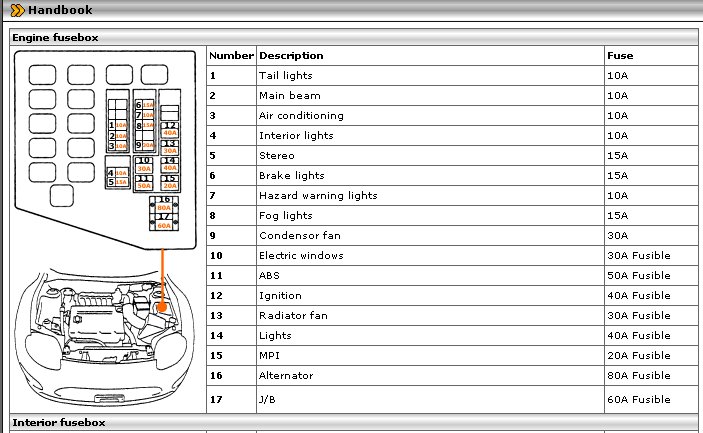

Re: fto wont turn over
Check number 12, or swap 12 and 14 to see if it will turn over

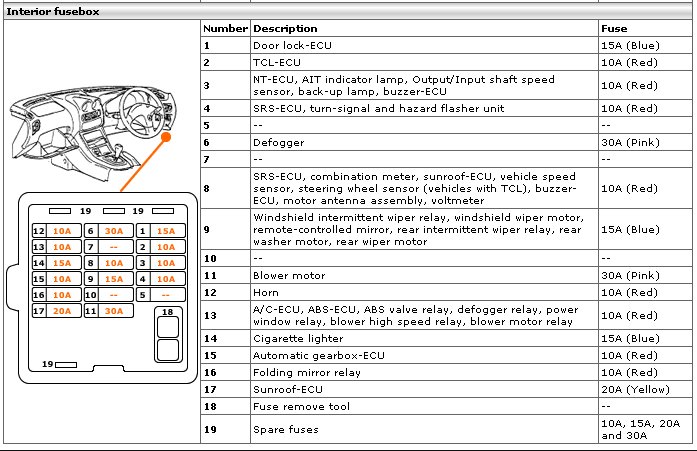

Fuse box inside the car.
Which one?
- fuse25um.jpg (86.82 KiB) Viewed 980 times
Which one? He could just check them all
