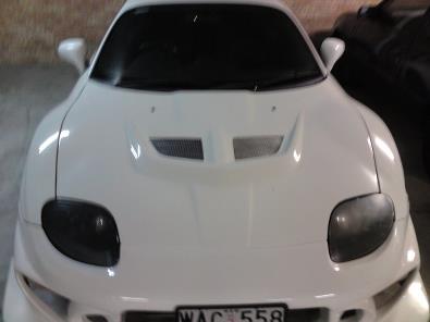

Hi,
Well... my first post here, so, hi all!
The engine in my GPX blew today... and... well... I need another :/
Does anyone have one to sell, or the best way to source one?
Cheers,
Matt
Cheers,
Matt
- Best photo I have on hand
- fto1.jpg (11.61 KiB) Viewed 1547 times
