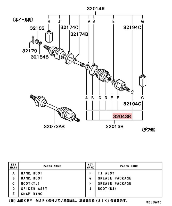

hey guys. need your help. i have a viscous lsd in my gearbox and need a new shaft, the original shaft was stuffed and thrown out. its proving impossible to find the shaft anywhere so was hoping some one could help me out if the know the part numbers or have one in their fto an wouldn't mind sharing the vin with me so i can find it using the Mitsubishi data base

Mike, do you want to flick me your VIN? Your's will have the viscous LSD. CAPS/ASA only narrows it down to the full 'joint kit', but that would be a start.

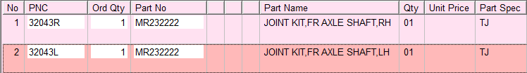

Hmmm, based on that chassis number, ASA is wrong.
It's feeding me the same part number for both sides: MR232222. Which makes no sense as we know both are different.
Re: calling all viscous lsd owners
Odd, it shows different PNCs but then the same part number but different part names...
Yeah that's weird... unless it's for a set? Unlikely... know where the part number would be on the shaft?
Same result as before.
Yup, same same
this is fucked! if it wasnt dark id go measure them LOL
SchumieFan wrote:this is fucked! if it wasnt dark id go measure them LOL
We know the measurements, we need the part numbers! :lol:
